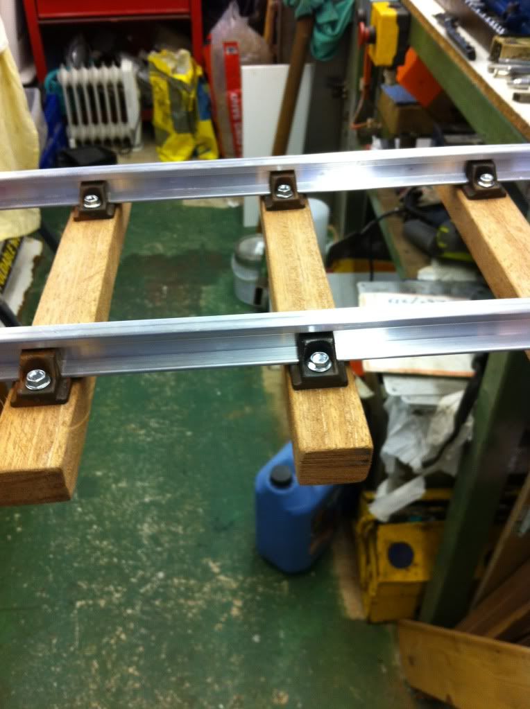

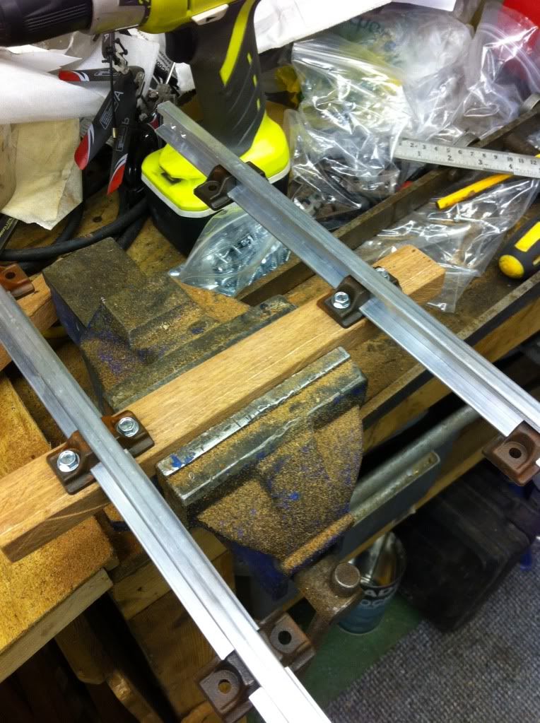

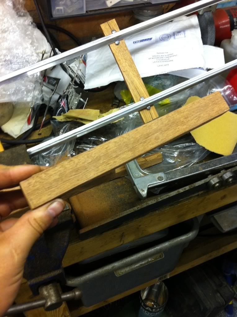

The track parts arrived so I got about finishing the show track first off tho I painted the chimney with heat resistant paint
Then made some sleepers from some mahogany
Then started fixing the track to the chairs
The finished track
Side view

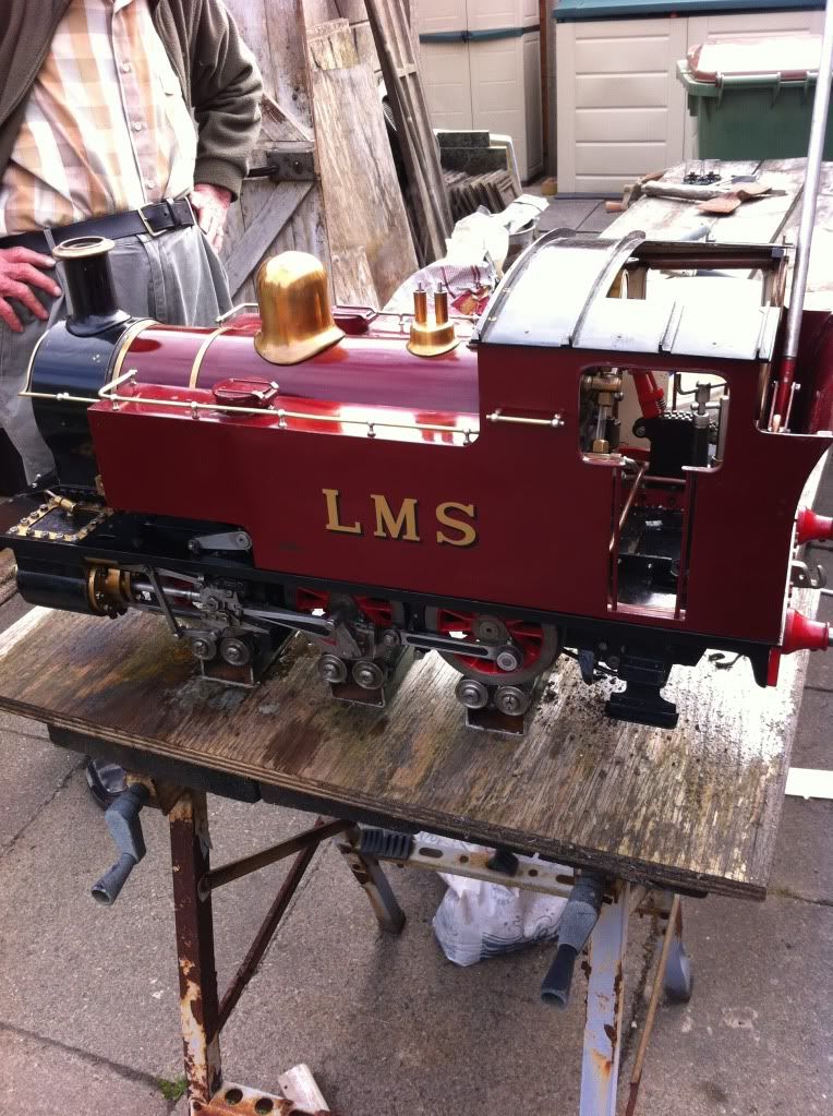

The train sitting on the new track

Finally the steam test!
Well it turned out a bit ouchy I got a Stella steam burn lol
Any way good news and bad news
The bad news is it didn't go too well it still too stiff to run correctly so I need to strip down again which is prob not all that bad ;)
The good news is I got a video of the whistle
The next bit of good news is the chimney restricter works a treat the fire lasted loads longer without loosing the steaming capability
And it looks fantastic in the daylight as well

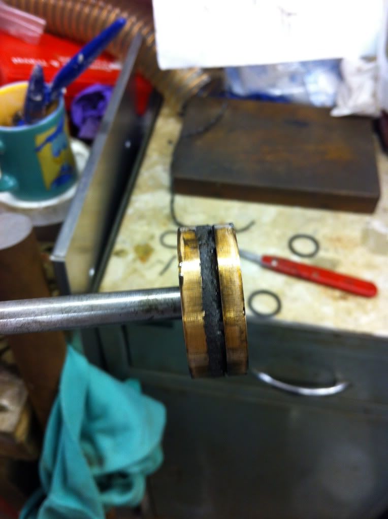

Postby Dougs » Sun Aug 11, 2013 3:12 pm

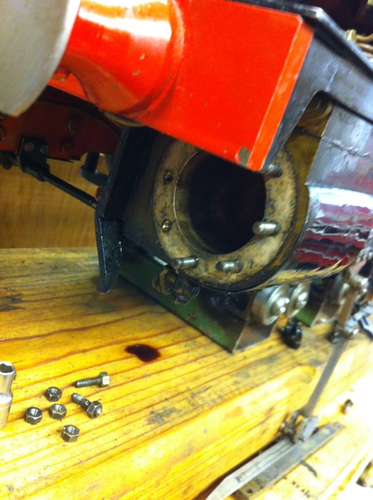

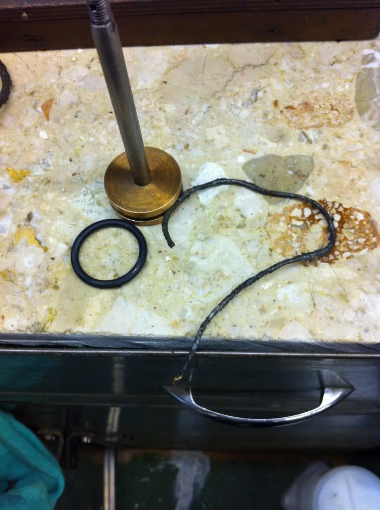

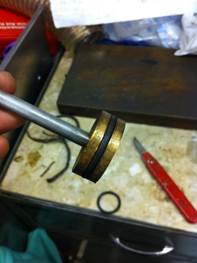

Yes basically it runs a treat on air so my grandfather and I worked out that it has to be the orings going soft when hot so they are coming out and being replaced by the correct material grafite yarn which should get things moving along nicely not really a big job either one afternoon should do it I have the yarn already so just need some time :)
Ask and ye shall receive I got some spare time so I got to fixing butch
Removed the end covers
The offending item the dreaded o-ring
The new old school seal
The grafite yarn on the piston
And,,,,,,,,,,,, it works a treat :D :D
Totally transformed it, lesson learnt don't deviate from the original unless you have to
