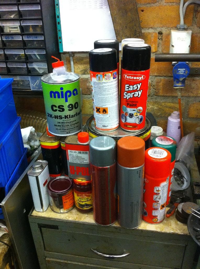

first off the paint that was required for the respray all collected up in one place :-o and no the jalapino's are not a secret painting tip but a very useful storage jar for mixed touchup paint ;)

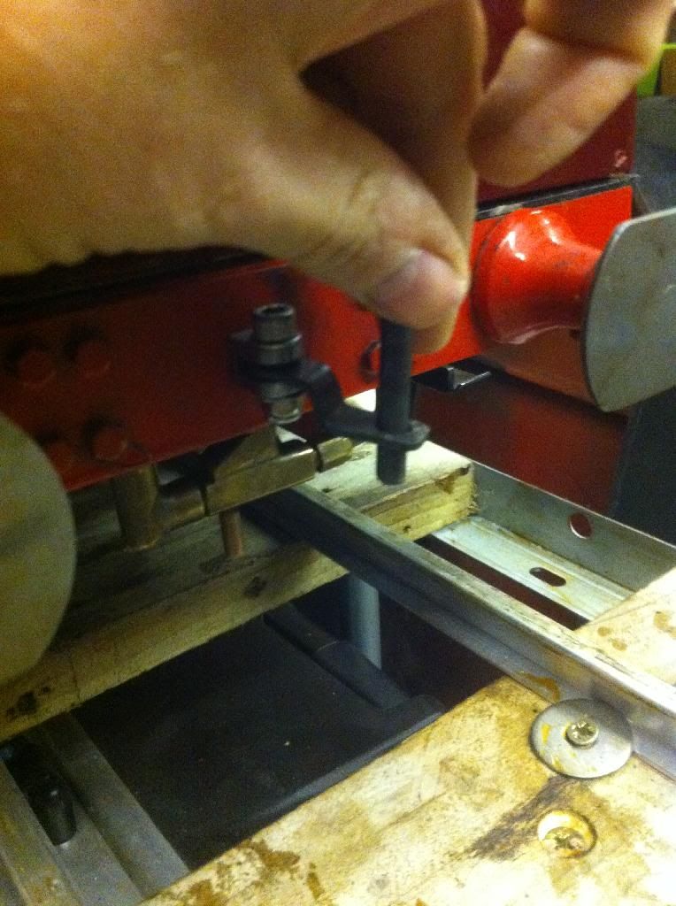

next job i wanted to make a connection to the club trucks that would allow me to tow passengers so i removed the hook (which is now just for display perposes) and made a new draw bar and link to get the correct height
and a pin dropping into the towing eye

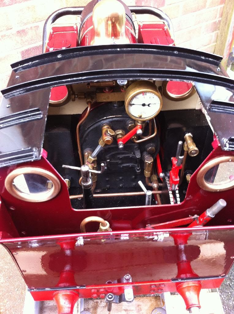

with that done i turned my attention to the cab the sight glass has a tap on it this is to clear any air locks and give a good indication of the water level in the boiler well the problem was the when the tap was opened it filled the cab with hot steam so i couldnt use it without poaching my hand
so i made a nut and an olive then connected a bit of pipe to blow the steam underneath the train \:D/

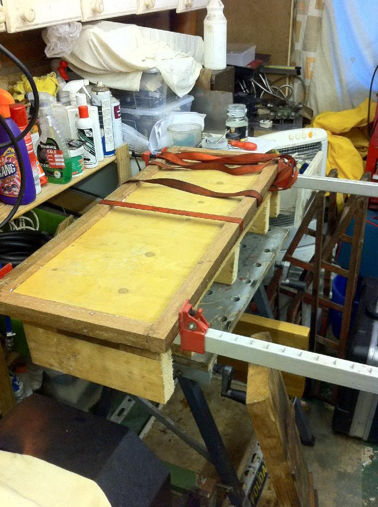

so now on to my latest job making a display stand i already have some track and rail chairs that look quite good but want a base that i can screw it all to and infill the gaps with stone so it looks much better.
so i have some ply cut roughly to size unfortunately i will need some good weather for the next bit as i need to saw alot of wood for the edging strips

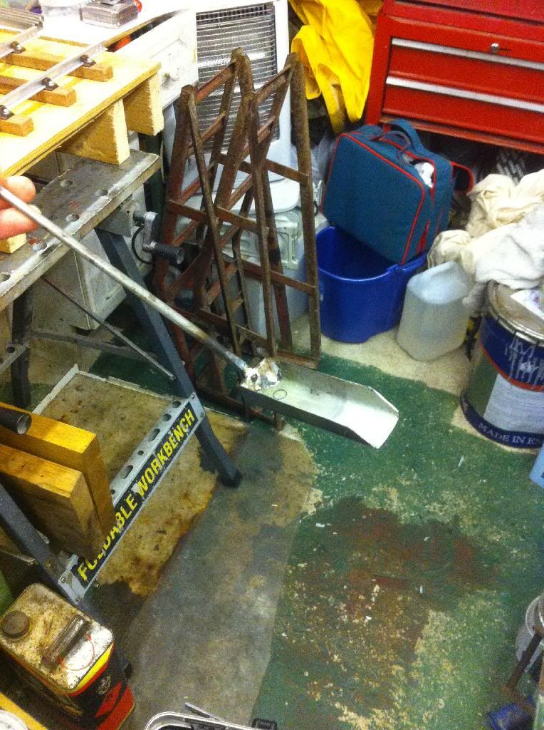

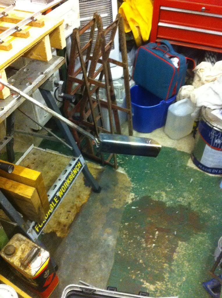

I have made a new coal shovel the old one I made was aluminium and was falling apart so I decided steel was the way forward!
bashed a new shovel out of some plate, then silver soldered it up. Its a beauty if i dare say so myself, very stirdy!

did a little work on the cab too, just to tidy it all up a bit
all looking rather smart now

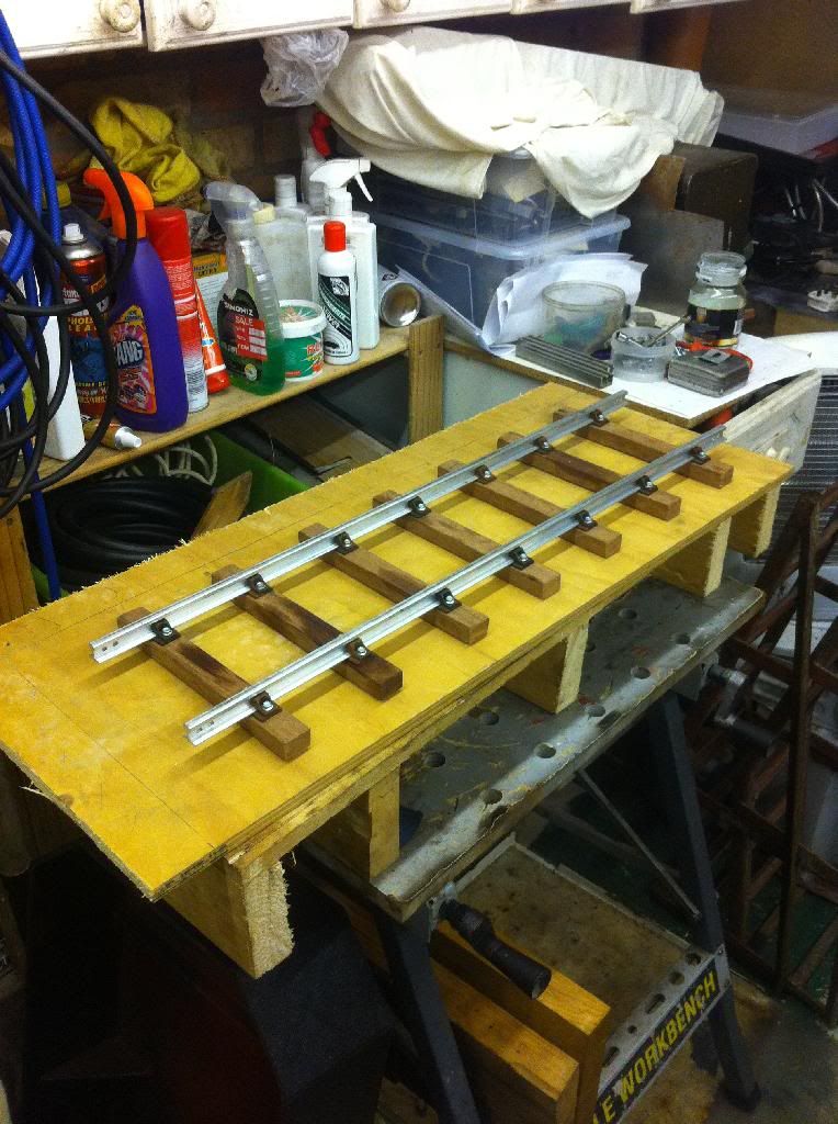

quick update today

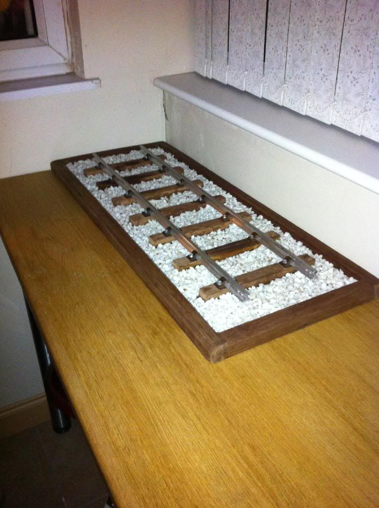

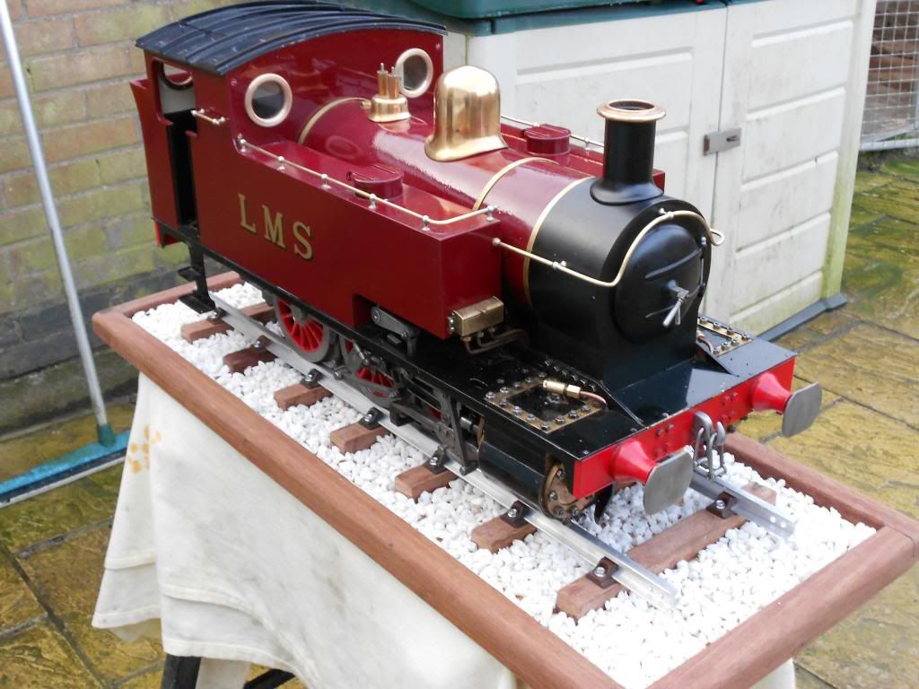

the photo i promised of the finished show track

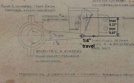

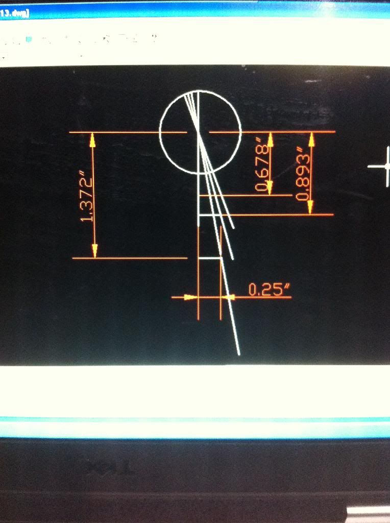

and on to the planning stage of the pump so basicly i needed to find out what i need to do to make the pump work well so i drew up the measurements on autocad
this basicly shows me the movements that are involved with the pump ratchet so from this i can make this deduction;
this diagram of the pump shows the maximum and minimum arm lengnth i can have for one stroke of the ratchet ideallly the arm should be the smaller lenght so that it will cover more than one ratchet claw each stroke curently its about spot on one ratchet length so some times it works some times it won't if i am at just under two ratchet lenghts then it will work every time without fail and alllow plenty of slop for wear so i have to take it apart and make a new bit :D

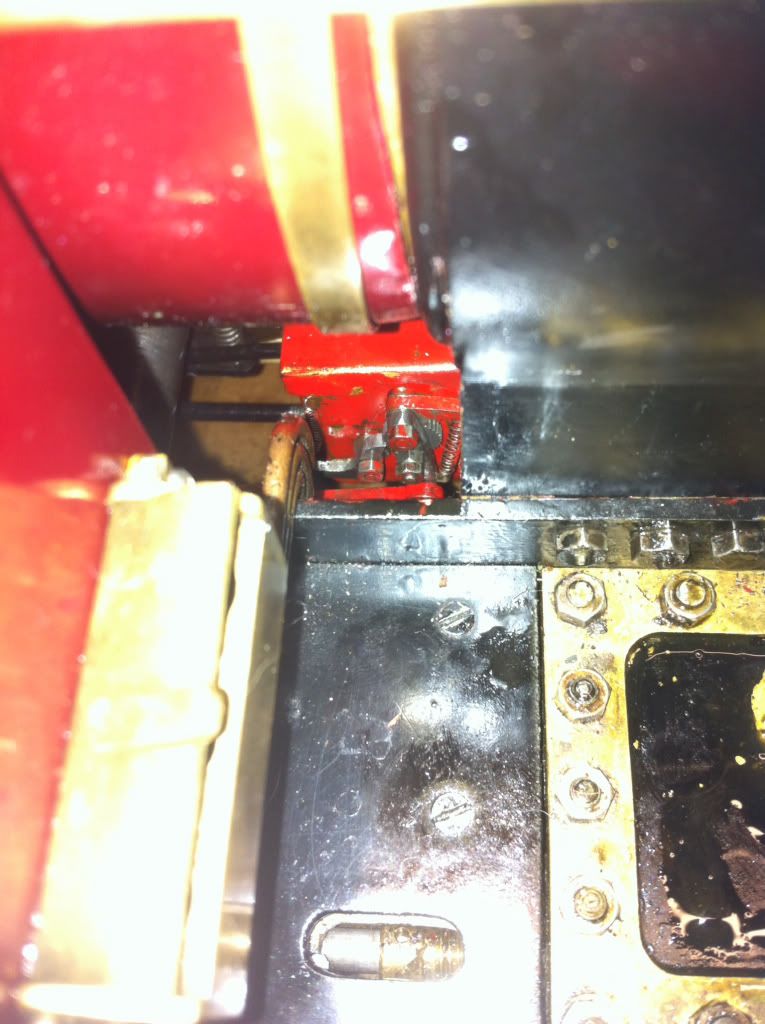

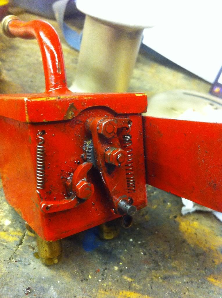

oh nearly forgot a pic of the real part to show what i am playing with

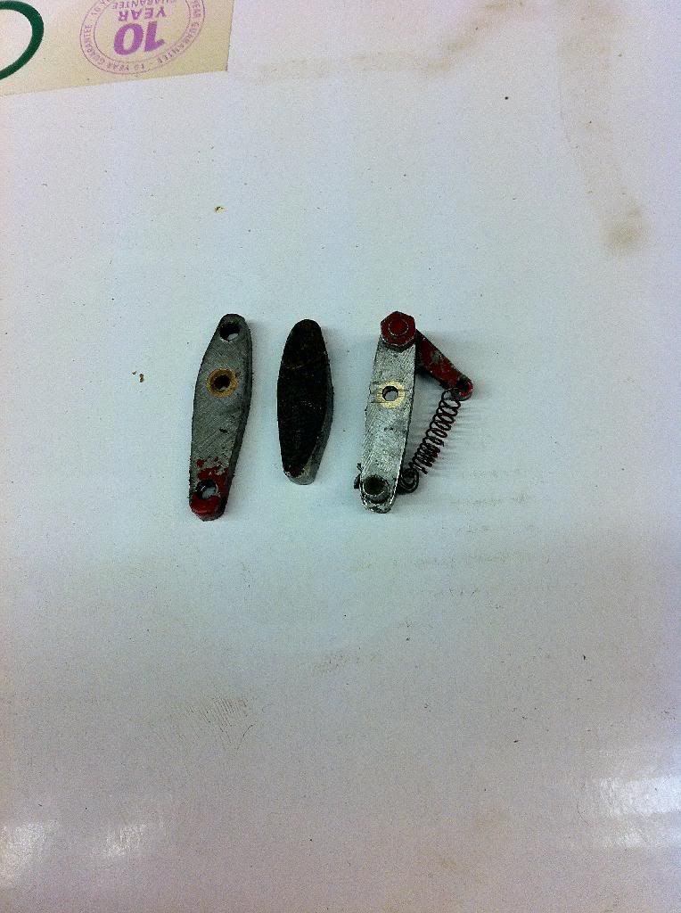

i have made a new part over the weekend the one on the left is the original. The one in the middle is too small so i binned it half way though making it and the one on the right is the new part. I just have to get it put back together now, which is a pain as i have to take the front smokebox off to get at it. Then hopefully it should all work fine (cough cough) :p

Postby Dougs » Tue Jan 07, 2014 7:28 am
Well put it all back together and (drumroll........................) it works perficly :D :D \:D/

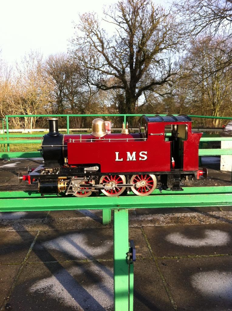

Postby Dougs » Sun Jan 12, 2014 5:40 pm

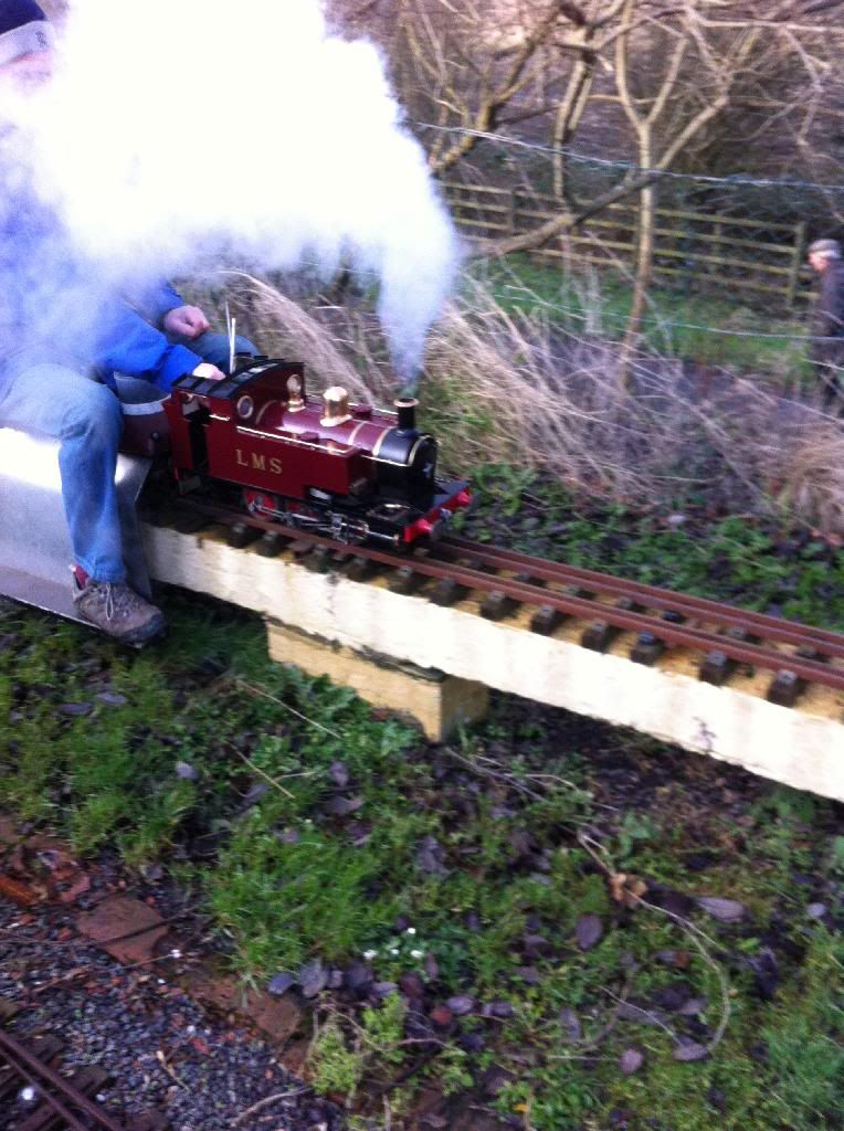

Well what a day! Time to test out all the work I have been doing all these months
Started up in the steaming bay no problems getting the fire going :)
I did a couple of laps then handed over to the club chairman to have a blast see what he thought of it
Gave me a chance to see it in motion very nice :D
I ran for an hour and a half without any issues "jobs a good un"
That's about it from me I can safely say it is now very restored! :D I am super happy I now have a good running engine and can get on with building my new one \:D/
Thanks for reading this topic I hope you enjoyed it. I may post on the topic again at some point in the future if I have any big news or any upgrades. But as far as the restoration goes I don't think there is any more to do :D :D

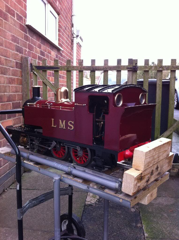

Postby Dougs » Sat Jan 18, 2014 6:51 pm
I had to post this photo my new pressure guage fitted should make driving a bit easier the old one got in the way a bit plus this one is more to scale

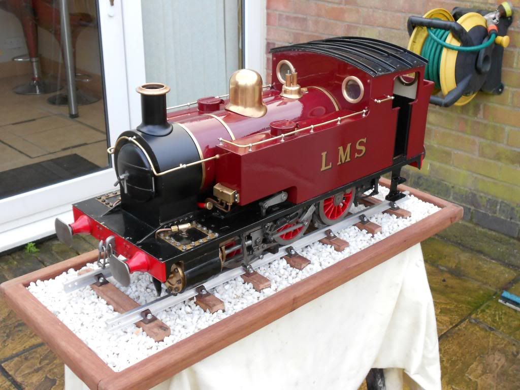

By the way ... you posted a picture of the finished show track .... and several of the finished restoration ...
But what about a picture of the finished restoration ON the finished show track :D :D

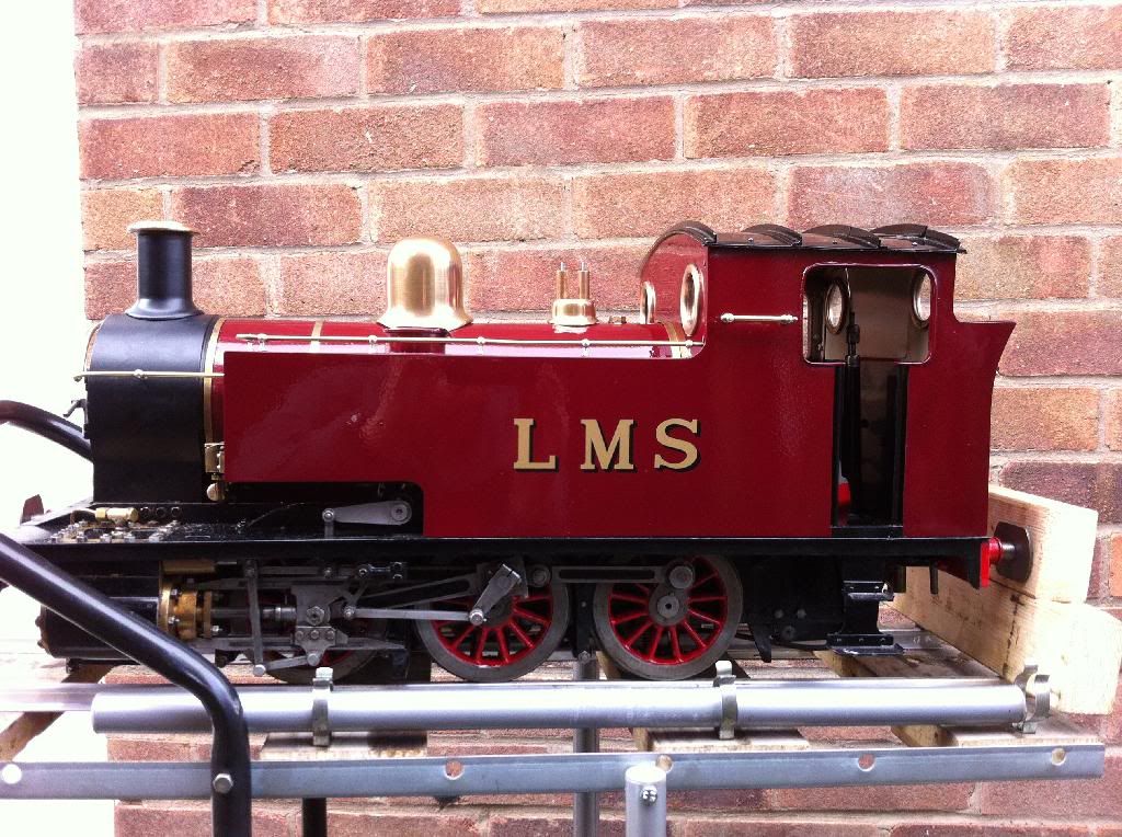

Postby Dougs » Sun Jan 19, 2014 11:11 am
Spitfire wrote:Nice ....

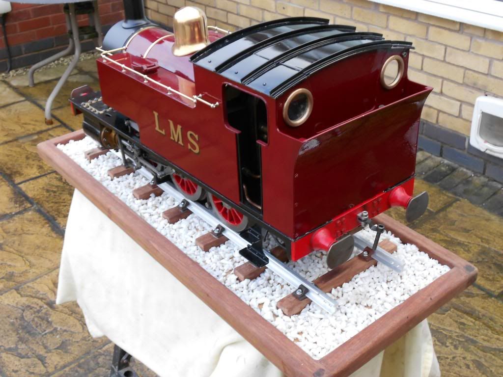

Good point I will get a pic done :D I am getting a name plate made for the show track too
As requested
