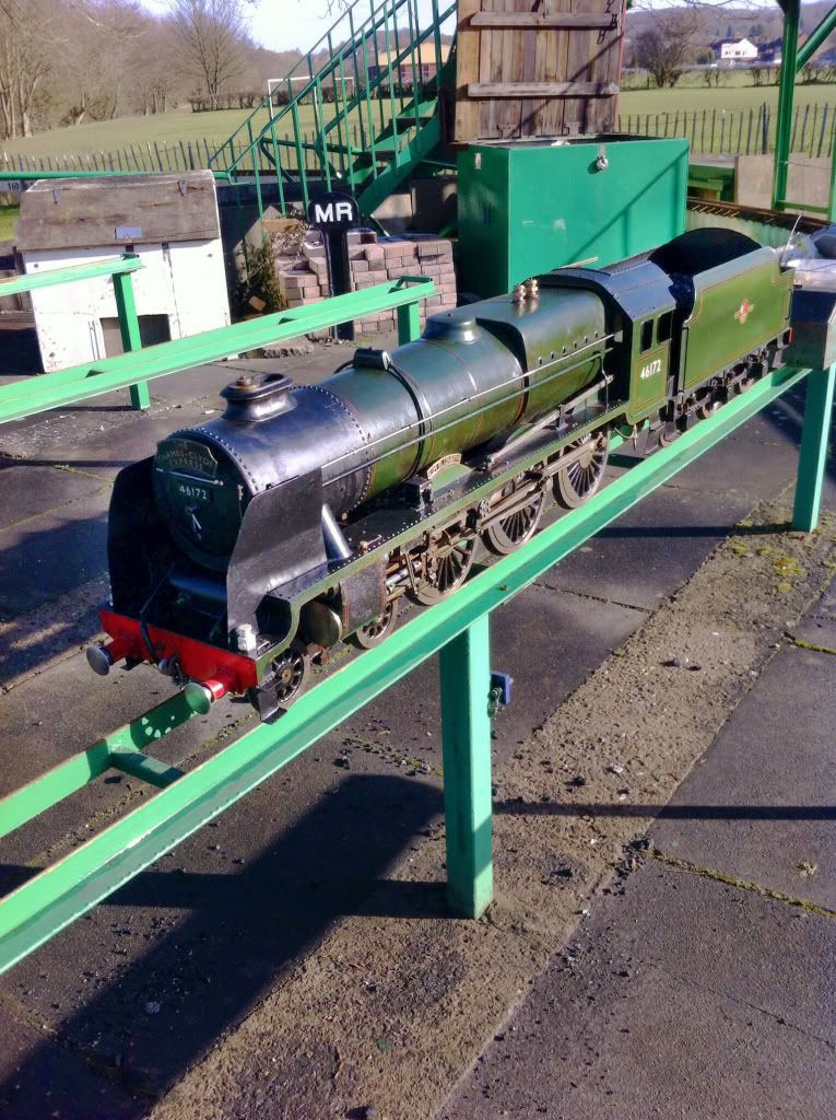

Postby Dougs » Mon Feb 17, 2014 1:37 pm
Was rather good fun although I spent all my time on track being chased down by this monster
very nice running engine it has 7 and a bit inch wheels :-o so it shifts a bit although I think my passengers got good value as the ride took quite a bit longer :p

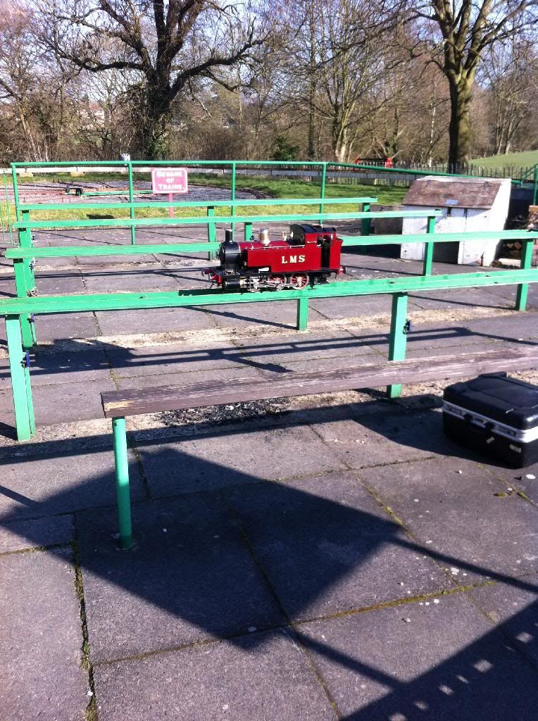

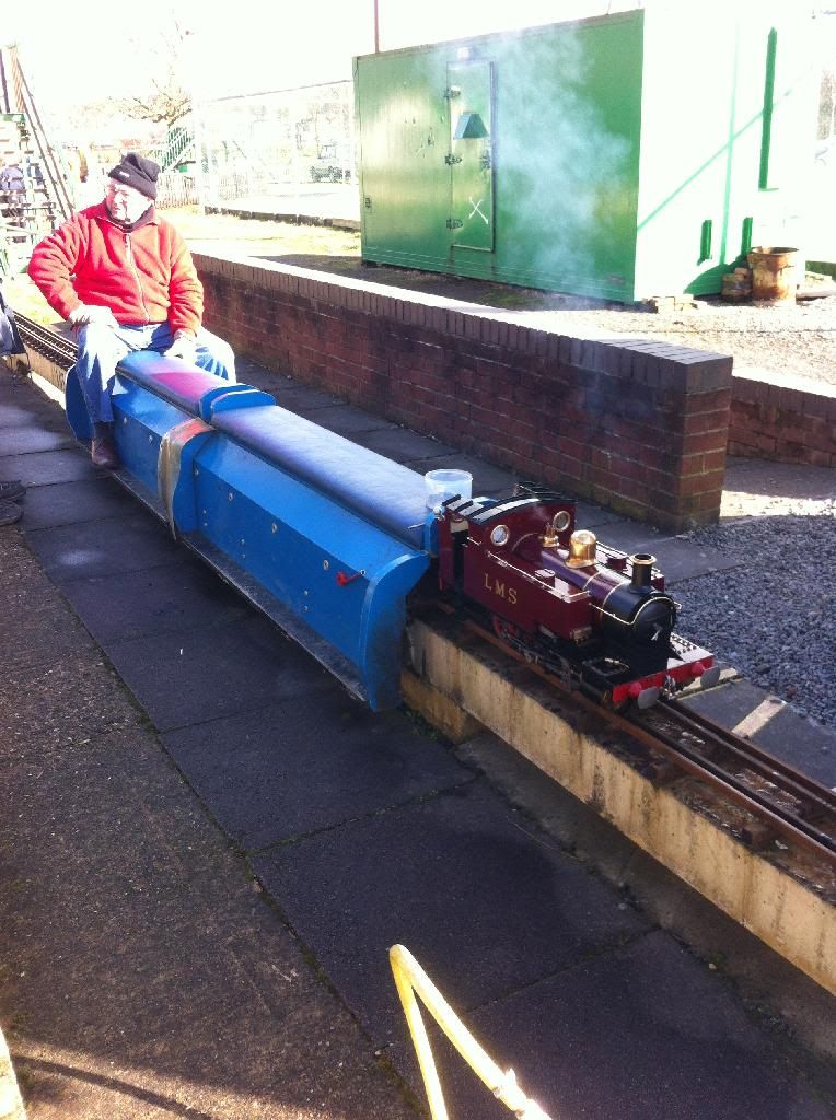

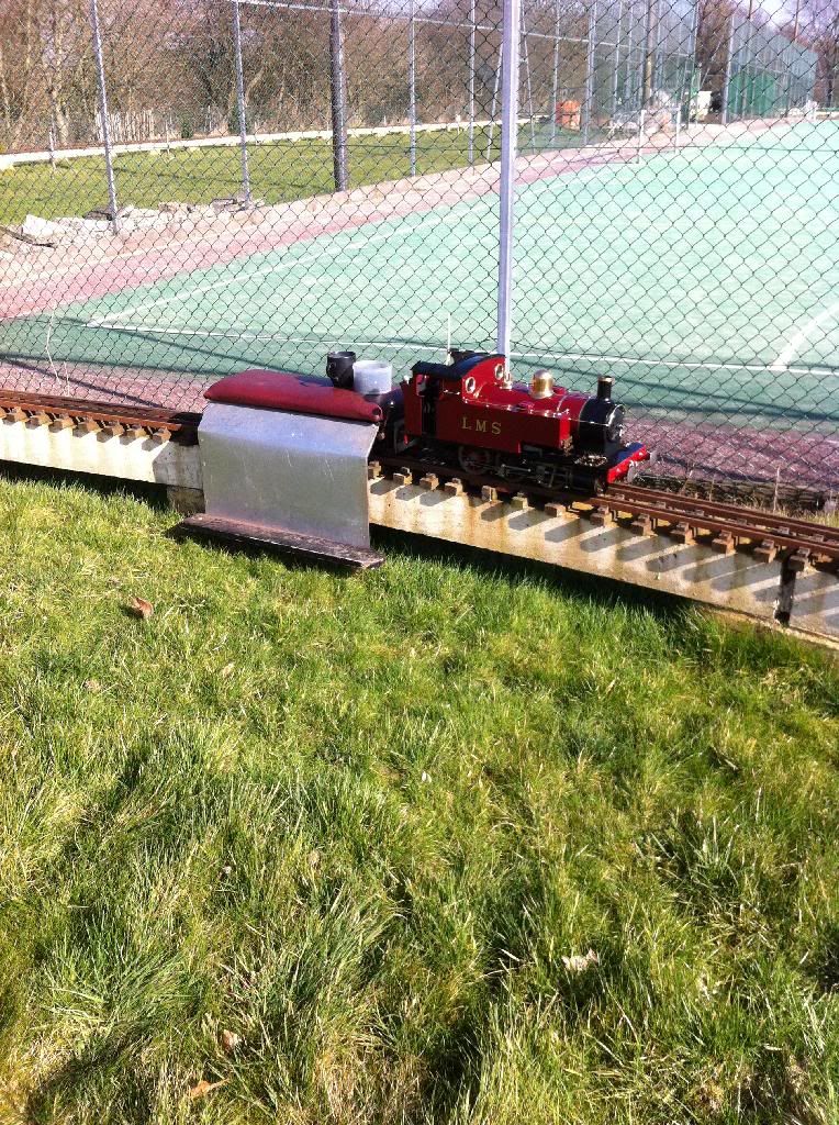

Postby Dougs » Mon Mar 10, 2014 1:49 pm
A couple of photo's of Butch running this weekend
sitting all lonely waiting to get steamed up
the one bad thing about the driving cars is there are no cupholders for your tea :p
I then got to thinking what if i made a video of a ride on the footplate so i will be filming one over the next few weeks and will share it when finished but here is a taster for you.
she ran very well indeed the efforts of pulling passengers seems to be very beneficial i am gettting better at driving too and learning lots of tricks like getting the fire running properly (makes a huge difference) i have also found it likes smaller bits of coal seems to run much better. :D
next week i am passenger hauling again so hopefully i will be better than last time

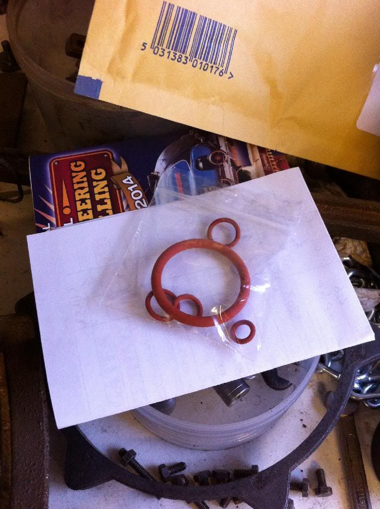

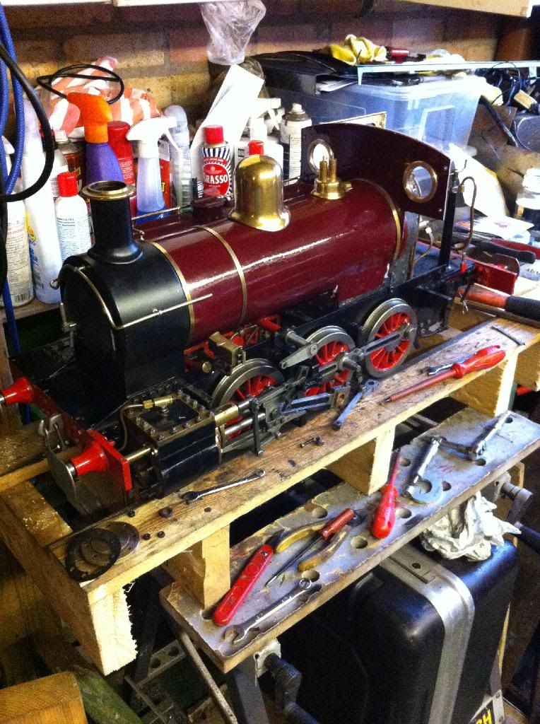

Postby Dougs » Wed Mar 19, 2014 9:13 am
a small bump in the road to report I am afriad
I was running on sunday and had a breakdown the gland seal blew out on my valves this is a small bit of string that is covered in graphite and oil to seal the valve, so i am back to taking it all apart again :D
I am replacing all the seals with Orings (I know I have been here before but i have had some advise this time) so i am fitting silicon orings these are designed for use in hot and wet enviroments
more importantly they wont blow out hopefully I will give them a good test and fit them to my new loco if it works out ok.
anyway I am also starting the build of my coal waggon so I will start another thread to cover this.

This is what world class fettling is all about ... try it - find the weak spots - take it to bits again - drink tea - mull it over - drink more tea - improve it - rebuild it - feel smug and drink more tea - try it again :D :D

Postby Dougs » Fri Mar 21, 2014 2:37 pm
34053 wrote:Sorry to hear about the 'blow out', Dougs. 'These things are sent to try us', as they say!!!
its all good experiance Ray and I get to play mechaninc again :D
if it happens again with the orings I can just tighten it back up so it has helped quite a bit, also I think I will be gaining alot more power and quite a bit more efficency looking at the state of the seals I have removed so its actually turned out to be a bit of a blessing.

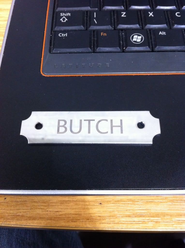

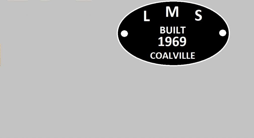

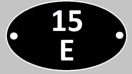

as I have it in bits again I am going to add a bit of detail the makers plate the photo below shows the design but it will be tiny 14mm wide
and while i was at it i thought one of these for the door would be good
its a shed plate that relates to coalville in the late 60's

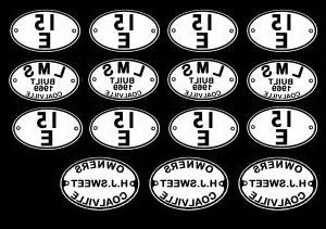

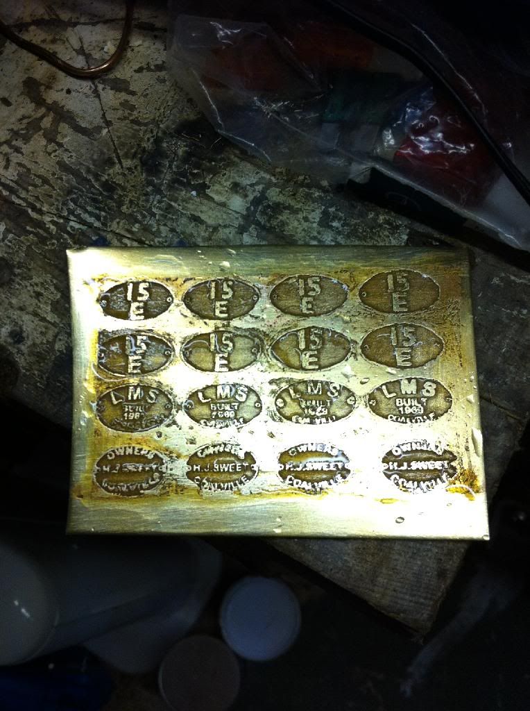

Postby Dougs » Sun Mar 23, 2014 10:59 pm
I have fixed the "blowout" and I need to test it out but it looks awsome the seals are great on the valves and pistons, I have also started the loco builders plates and shed plates the negative mask is done
there are a few spares as the etching may not go perfectly so I can at least pick the best of the bunch.
That's the one thing with this hobby you never know what you are going to learn next I had never even thought about etching, I had asked a workmate to look at laser milling a plate for me but he was busy so I looked into alternatives so I could get it made quicker :)
There will be a slight delay as I have to order some etch fluid and some masking equipment I will post up the results when I get sorted

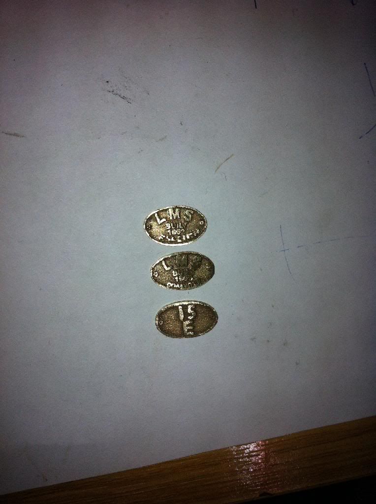

Postby Dougs » Mon Mar 31, 2014 8:16 am
bit of an update on the loco plates they are etched ready for painting
really easy to do and this is what they look like trimmed
the top one says F.Sleigh who built butch (thanks to spitfire for that one!) the middle one is a nearly standard build plate and the bottom one is the Coalville shead plate

Postby Spitfire » Mon Mar 31, 2014 9:39 am
Dougs wrote:the top one says F.Sleigh who built butch (thanks to spitfire for that one!)
There you go - history recorded for future generations ...and posterity :D
Your extensive rebuild and your name should really have been recorded too - like I said not necessarily on a visible plate but somewhere underneath perhaps ;)
Dougs wrote: so it needs a bit of a "run in" to free it all back off again it does WHOOPH more tho ;) so I can tell there are no leaks anymore!
:D :D :D :D :D :D Yay for the WHOOMPH :p
Postby 34053 » Mon Mar 31, 2014 1:42 pm
Plates look good, Dougs. Also, pleased to hear that your Loco' is now 'leak free'.
