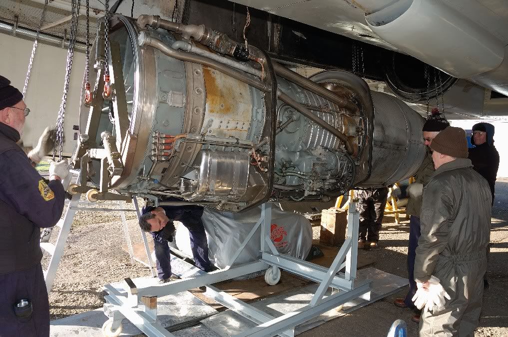

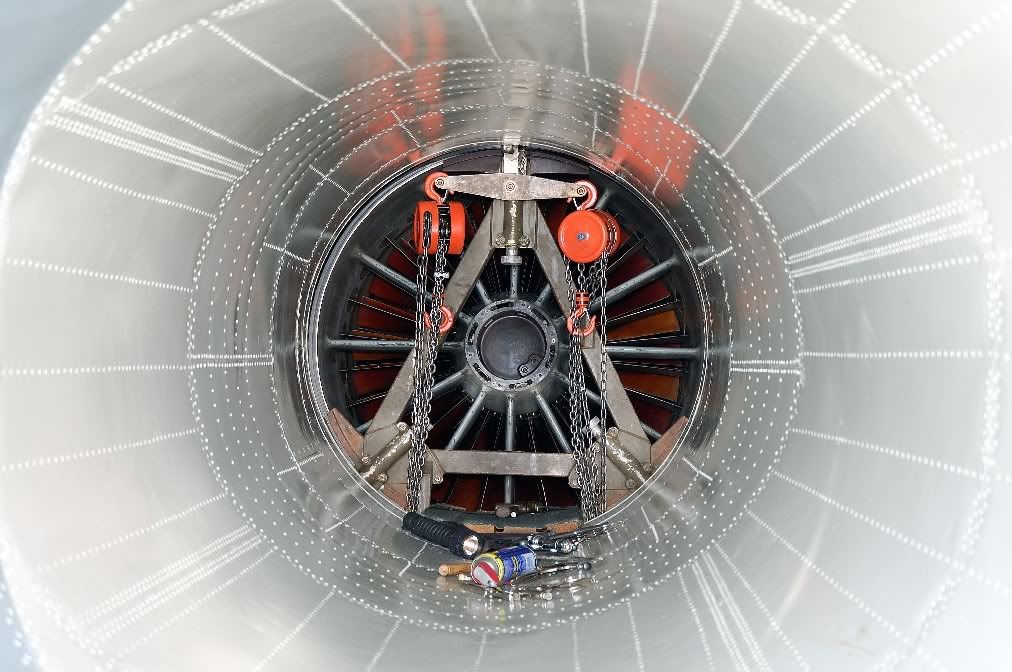

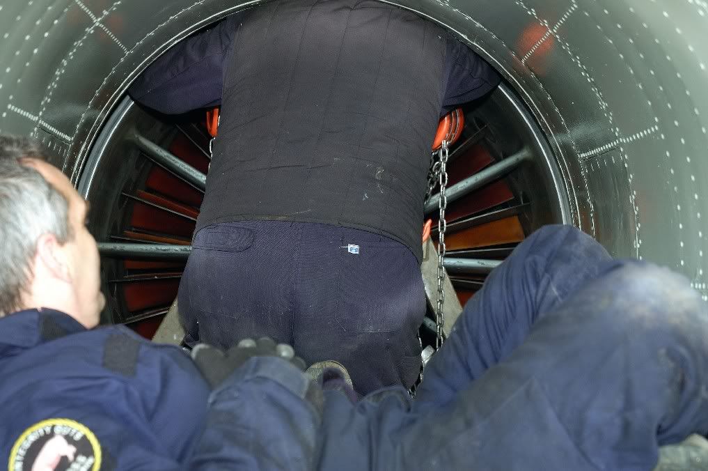

As our regular readers will have noticed from the lack of progress reports, engine removal has been delayed for the last two weeks by a seized pip pin in the airframe over the front of the engine. This pin is used to mount the lifting/lowering equipment, and in theory is only fitted when the equipment is in use. Unfortunately, a pin was left in 655 at least 25 years ago, and now it doesn't want to budge. The access is VERY restricted, and after two Saturdays struggling, we decided to make a modified lifting attachment so we could use the pin in-situ.
With the modified arrangement, we had no problem installing the equipment, the engine was lowered without any significant problems, and was safely in the waiting stand by midday.
In the afternoon, we made a start on the dismantling, and got most of the bits and pieces over the LP compressor case out of the way by the end of the day.
Externally, the engine is in very clean condition, but of course what really matters is the condition on the inside. We expect to have the LP compressor top half casing off next Saturday, and we will then have a much better idea of the engine's condition, but so far, everything looks good.
Here are a few pictures to give you all a flavour of our busy day - all the pictures were taken by Charles Brimson.

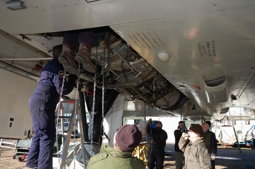

This is the front lifting/lowering equipment in position.
Access to the front mounting bolt is a bit restricted on a 301.

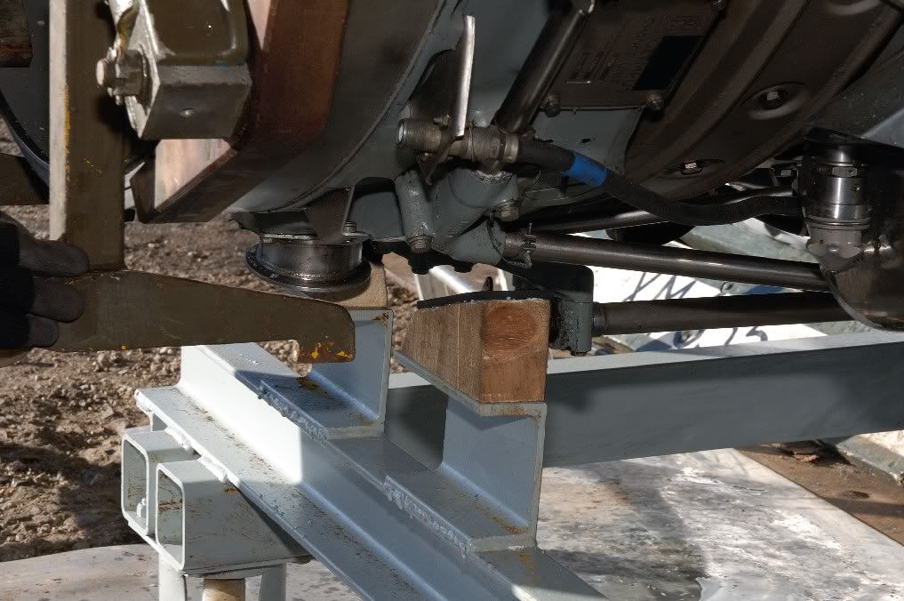

We selected two team members with long arms and short necks to remove the pip pins from the main trunnions.Image

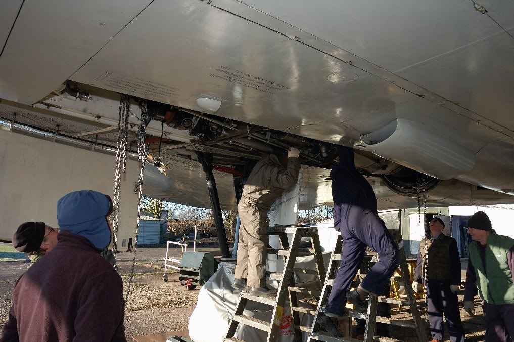

Whilst lowering, the CSDU electrical connections need to be watched for hang-ups.

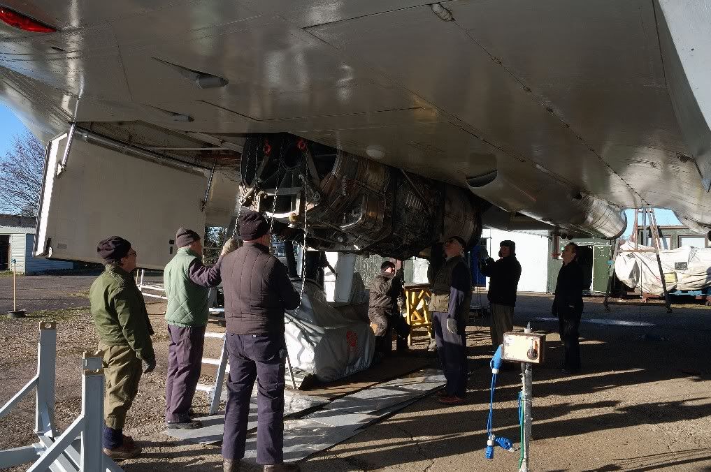

The engine is almost clear of the airframe.
When it was clear of the airframe, the stand was positioned underneath.
With the trunnions already secured, the intake casing is almost on the pads.

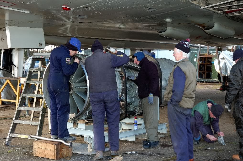

We had plenty of time to make a start on the dismantling.
And we left the engine well wrapped up at the end of the day.
