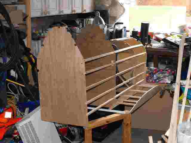

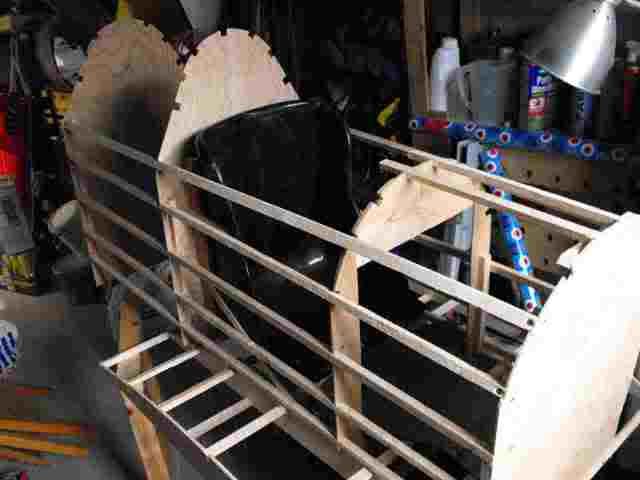

Re: advice needed to canvas an aircraft
Postby Dougs » Sat Aug 22, 2009 3:49 pm
Thanks for the advise dan4th
a couple pic of the frame so far i will take some better ones when i can take it out of the garage but i think you will get the idea from the pics,
