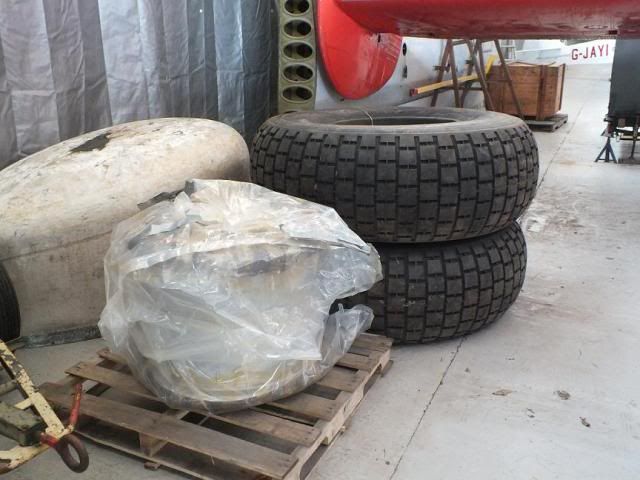

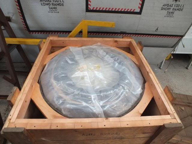

Well, today was all about manual labour. We had found out the mainwheels we required a couple of weeks ago, but that was only part of the story. Getting them from the depths of storage, then from store to the airport, and then into the hangar took all morning.
Hard work and strength in numbers paid off, and by 1300hrs, we were back on site and unloading!

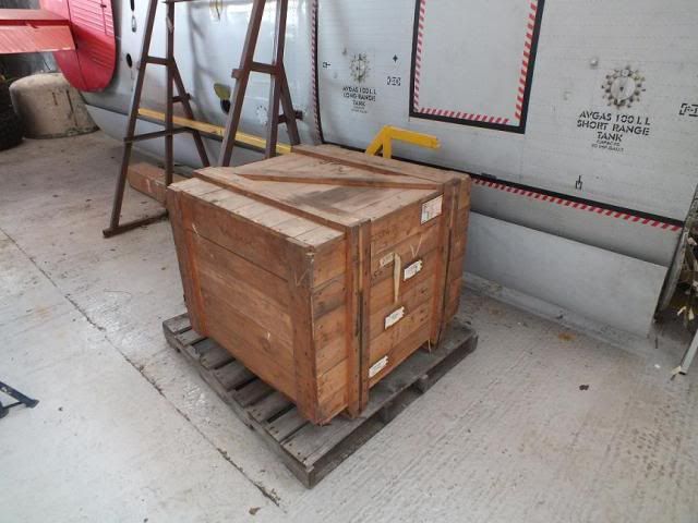

One hub is brand new in the box, and one was just wrapped on a pallet. We have found another brand new boxed one, which is now marked for easy identification should ever we need it. A lot of stuff has the original movement labels on, but a lot of boxes are unmarked - like the one which had god knows how many exhaust pipes in it. Or the one containing the axles!

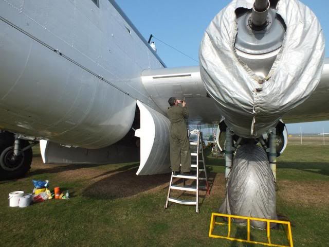

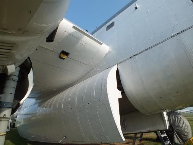

Over on WR963 herself, one of our team was attacking the screws for the cover panels over the jacking points. One panel came off okay, the other is putting up a bit more of a fight. It may need a couple of the screws drilling out.
Inside there are five large studs protruding from the lower boom. The jacking pad itself bolts on to these, and it can just about be seen in this picture -

Theres a lot of Lanc in a Shackleton centre section - it comes with it being a derivative of the same design. Interestingly, the last people to use our drawings were BAe/BBMF in the mid 1990's for PA474's respar.
