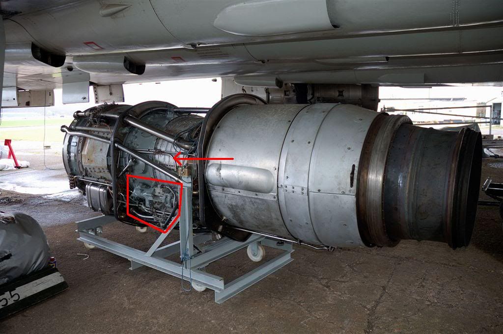

Postby Sooty655 » Thu Jul 07, 2011 10:37 am
I've looked through our engine inspection pictures from 655, and I haven't found anything particularly helpful. Best I can do is this one.
The CMFS is enclosed in the red polygon. It comprises the two fuel pumps and their associated governors, plus the throttle valve, air fuel ratio control and various other control components.
It is a big lump and not very accessible. The arrow points to a hollow tube which is permanently fitted to the engine, and is used to guide a hoist cable to allow the CMFS to be lowered after it has been disconnected and unbolted from its mountings.

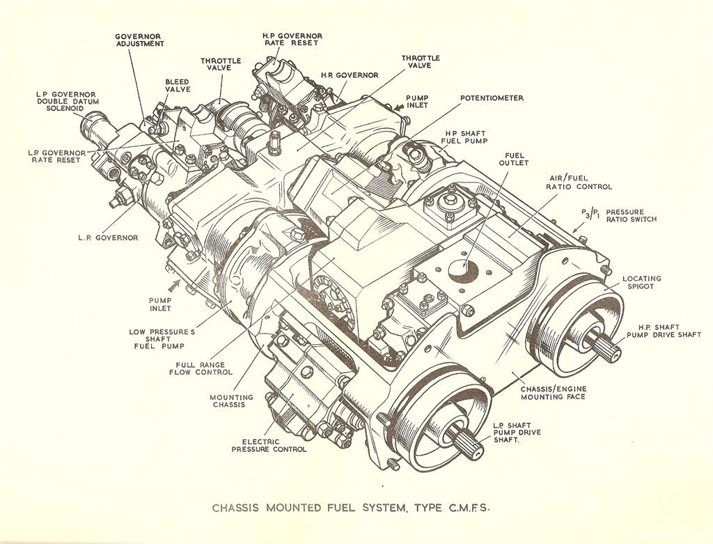

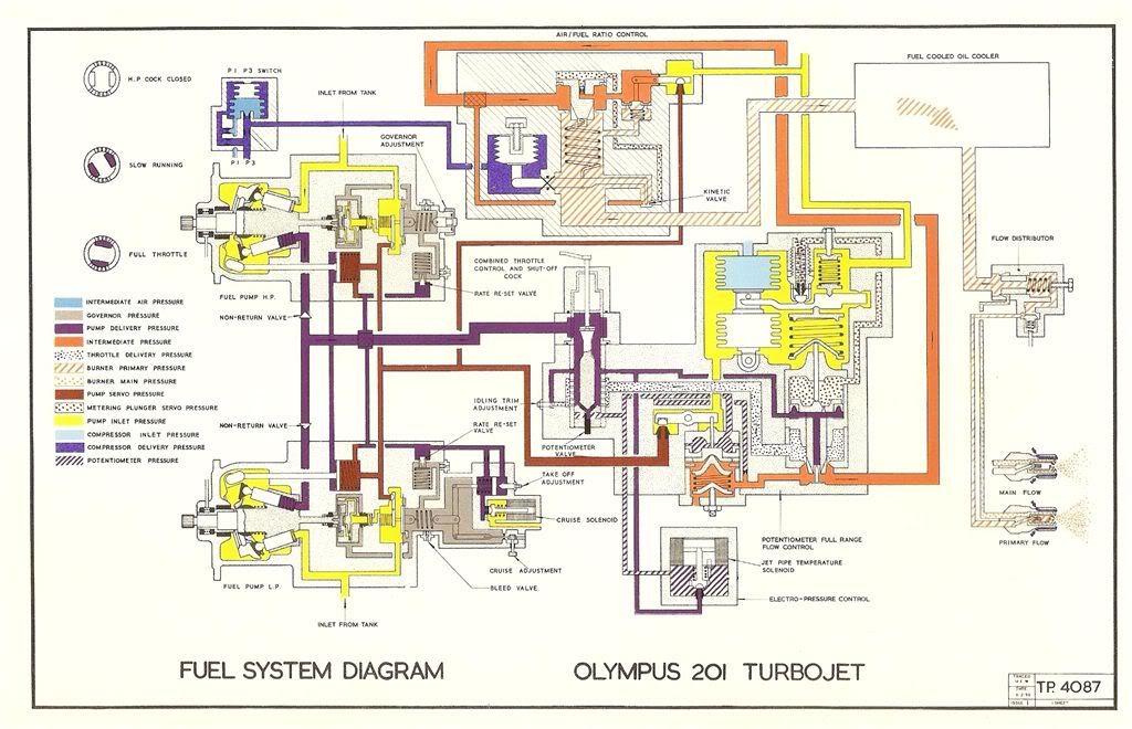

Edit: For those who are interested, this is what the CMFS looks like...............
......and this is what it does.

Postby Sploosher » Thu Jul 07, 2011 11:20 am
Thanks for the pics and description Sooty................................ :D

Postby MOD » Thu Jul 07, 2011 5:47 pm
Thanks for the diagrams Eric (Mr Olympus) ;)

Postby RLN » Thu Jul 07, 2011 7:09 pm
Thanks Sooty, I get it now. It uses the fuel as the hydraulic medium to control fuel flow depending on various parameters.
