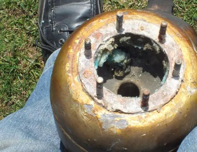

The object of today was to replace the coolant header tank on No 4 engine, due to the corrosion found on its base. It looked a fairly simple job and should have been, but some things just like to fight.
Once the coolant was drained, the first problem was the pipe off the bottom. A vintage 1971 rubber hose, it soon was off after being cut along its length. The cork anti chafing strips had stuck to the tank, and the retaining straps, taking a hell of an effort to separate them!
Once we had the tank off, the new tank was unwrapped and it was discovered that it was basically a bare tank, so the fittings have to be swapped over. Thats when the real fun started...
The corrosion inside the tank meant that the fittings were extremely reluctant to come off. So reluctant that the tank is now off site with an engineering company to get them separated without damage, and make sure that they are good for re-use.

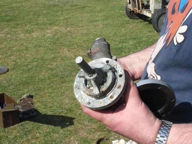

The only thing that did come off was the header tank relief valve... and it uncovered a real horror. Crystalised coolant, and sealant all gumming up the valve, to the point it didn't seem to seat or operate properly. This is probably the reasons for the small amount of venting often seen from this particular engine.
While we have done coolant changes, the relief valve doesn't really have any flow through it, as it is fed from an internal stack pipe above the coolant level... so we're going to have to pull the others off one at a time and make sure that they are not gummed up the same.

Edit:
Photos of the tank and the relief valve.

Blimey, that is a bit bunged up! :-o
